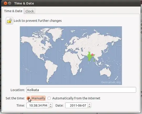

Have you tried changing the Time Settings to update manually?
