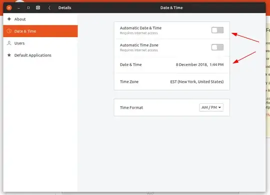

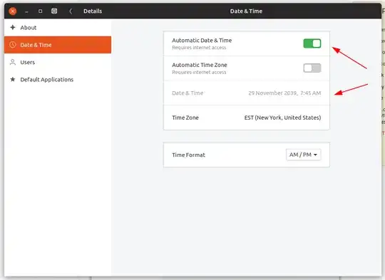

I have an issue where the date and time is set wrong when I use Automatic Date & Time in Settings to set the time from the internet. I've attached screen shots to show what happens when I enable the feature.
This is different from Clock time is off on dual boot because:
  • I don't need to boot into Windows to see the issue, I simply need to enable Internet date/time in Ubuntu.
  • the offset is not the time zone difference, it seems seems to be fairly random and the year is decades in the future. The attached screenshot changes my date from Dec 8 2018 1:44pm to Nov 29 2039 7:45am. I suppose time zone could account for the time different itself of 6 hours (even though my offset is ether 4 or 5, depending on time of year), but not the month/day/year differences.

Automatic Date & Time Off Automatic Date & Time Off
Automatic Date & Time On Automatic Date & Time On

I never found the answer for the 18.10 install, but after upgrading to 19.04 Automatic Date & Time started working again.
