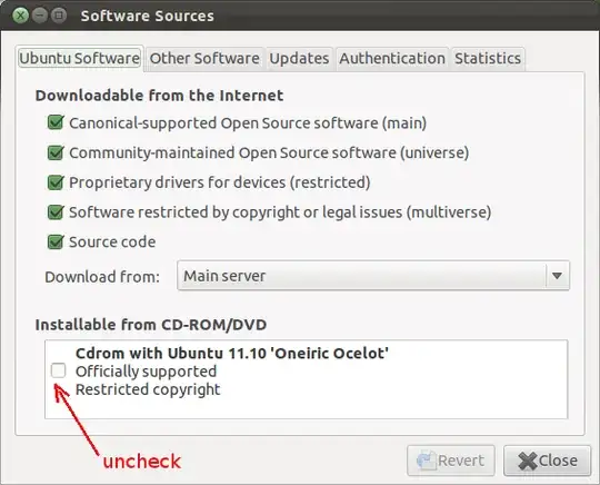

Run "Software & Updates" and uncheck checkbox near "Cdrom with Ubuntu" enter image description here

You have selected the CD-ROM as software sources, so it is checking the CD-ROM for the source.
To uncheck CD-ROM option go-to:
  1. system settings
  2. software sources
  3. other software
  4. uncheck CD-ROM option.
This will solve your problem.
