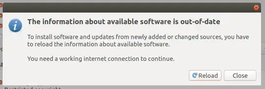

I also saw a post saying that I should go to Settings and select Select best server in Download from in the Ubuntu Software tab.
However, when I closed that window this appeared:
The information about available software is out of date
I pressed Reload and it ran a cache update, but when it finished it again said
Failed to download repository information
Check your Internet connection
Details
E:The repository 'cdrom://Ubuntu 18.04.1 LTS _Bionic Beaver_ - Release amd64 (20180725) bionic Release' does not have a Release file.
