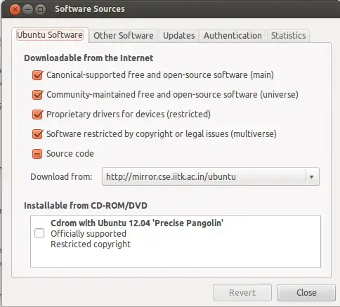

Go to Ubuntu Software Center > Edit > Software Sources and make following changes: Uncheck the Cdrom option in Ubuntu Software.Also make sure that you have marked all the other options. Software Sources

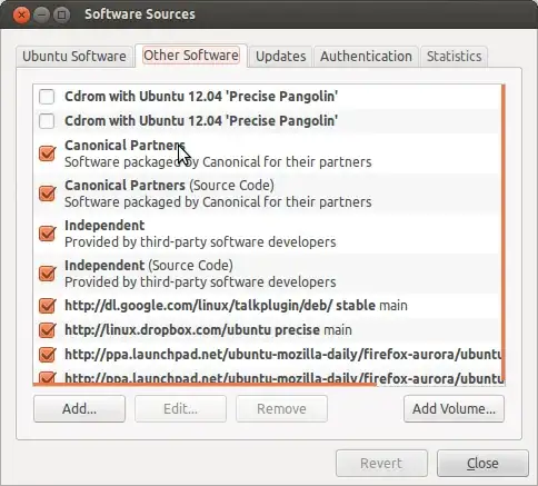

Now go to Other Software and uncheck the Cdrom options. Software Sources
Now try running sudo apt-get update
