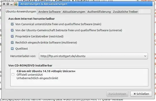

There is an option in your System settings > Software & Updates where you can (un)check whether you want to have your installation media as repository or not. I would advise you tu uncheck it. In my case, it's the option at the bottom of the window, but it might look different in other versions and languages.
Screenshot (German) of the Software&Updates window
