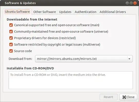

Comment the cdrom entry out in /etc/apt/sources.list, it's likely one of the first lines in the file. Another way to do it is the Software sources graphical tool.
grimpitch
  • 809
Execute the following command...
sudo software-properties-gtk
In the window which opens up,
Deselect the CD-ROM entry, in the Installable from CD-ROM/DVD
