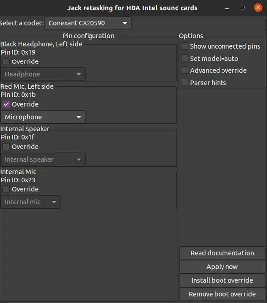

I am using Ubuntu 20.04 on my Sony Vaio VPCEH28FN with intel-hda-sound card. Output of cat /proc/asound/card*/codec* | grep Codec is Codec: Conexant CX20590 Codec: Nvidia GPU 1c HDMI/DP .
What worked for me was --
  1. I did sudo apt install alsa-tools-gui on my terminal.
  2. Then I ran the command hdajackretask on my terminal.
  3. Then selected Conexant CX20590 -- Red Mic--> Tick Override; from the dropdown select Microphone.
  4. Then selected "Install Boot override" and entered sudo password.
  5. I then restarted my pc and thankfully it worked !! My config on hdajackretask
  6. Also, I remember adding the line "options snd-hda-intel model=laptop" to the file "/etc/modprobe.d/alsa-base.conf" .

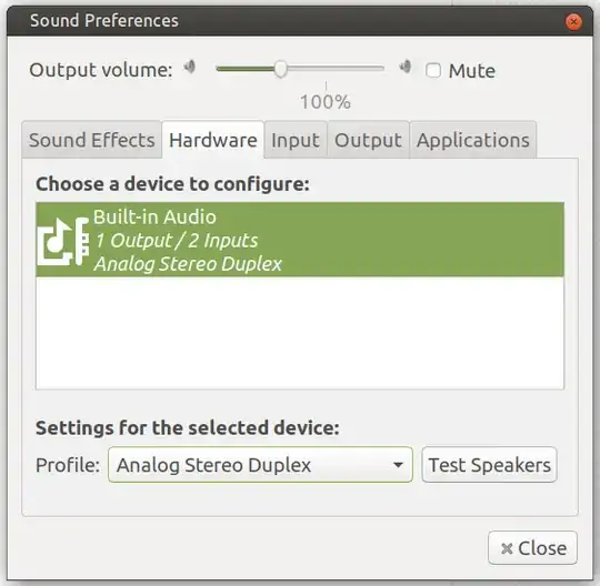

When I came to this question (and similar other ones), the fix was rather simple:
  1. Go to the "Sound Setting"
  2. Click on the tab "Hardware"
  3. Select the Profile "Analog Stereo Duplex" (it was "Analog Stereo Output" before").
Done.
Martin Thoma
