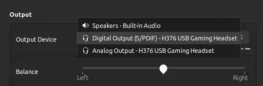

What I noticed is that on the Soud settings, the headset has two options for the headset Output, one analog and the other digital:
If I select the Analog Output - H376 then to hear anything, the volume must be at 100%. Any value below 100% the Output sound does not work.
If I change to Digital Output - H376 it works fine if and only if the Analog Outout - H376 was set to 100%, otherwise the Digital Output will not output any sound.

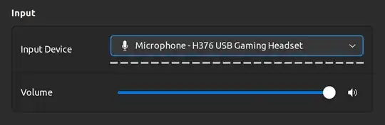

And the microphone, It detects the mic but it does not get any input signal on the input test bar:
