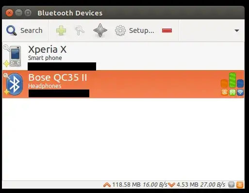

I've just installed a solution for Bluetooth not selecting the mic on my Bose QC35 II on Ubuntu 16.04 LTS.
Since the internal mic on my Samsung laptop is too close to the fan audio sounds like inside an airplane for all participants in a videocall.
The solution is Blueman that adds functionality for Bluetooth.
Install it: sudo apt-get install blueman
I had to restart network-manager (sudo service network-manager restart) after WiFi stopped working (could be unrelated, but hey better have it just in case).
Blueman GUI

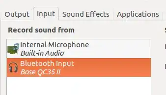

I can now switch to Headeset Head Unit (HSP/HFP) and choose the headset mic in Sound settings
Sound settings - input
Still a bit of a hassle when it does not switch automatically (like Android does) but it's still better than being in a Jumbojet storage!
