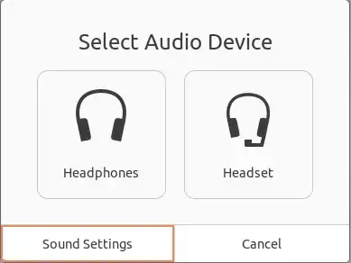

Whenever I plug in my headset, I get a Select Audio Device popup:
Naturally, I click Headset. Unfortunately, when I go to GNOME sound settings, I see that Input Device is unset. I have to then manually set it to Headset Microphone - Built-in Audio.
So my current workflow looks like:
  1. Plug in headset
  2. When popup shows click Sound Settings
  3. Manually set Input Device to Headset Microphone - Built-in Audio
Shouldn't selecting Headset automatically set the input device? Isn't that the point of the popup? Why isn't it working?
