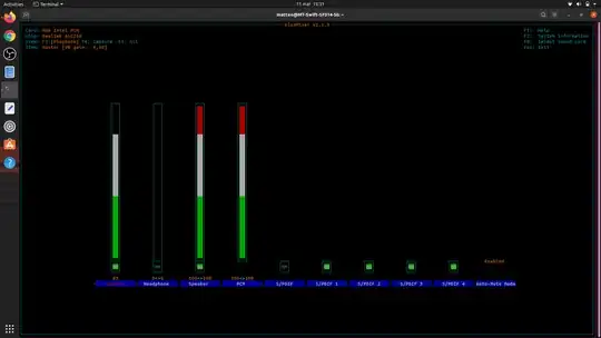

new alsamixer display for acer swift3 SF314-56 (Kubuntu 20.04 LTS)
Same Acer swift3 SF314-56 running Kubuntu 19.10 mic didn't work neither. Then updated to kubuntu 20.04 LTS, and after a recent kernel update (I have now a kernel 5.4.0-52-generic), the internal mic started to work with an updated kde sound control applet. Actually that corresponds to a linux kernel switch to SOF (Sound Open Firmware) infrastructure for intel audio. The intel HDA (with underlying Realtek ACL256 for our Acer swift 3 SF314-56) works fine now with new HDMI ouptuts controls (tested on my TV), and 2 new controls for mics (internal digital mic and headphone mic). But I still have an issue for headphone mic. Here an extract of kernel boot that explains the new module mapping :
