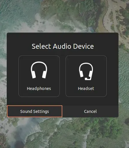

My laptop (Lenovo IdeaPad 330) has a fresh install of Ubuntu 21.10. During normal and regular use just after installation, the earphone mic was being recognised and it was functioning well. Then some time later, maybe a few weeks, the earphone mic wasn't being recognised. Pavucontrol says it is unplugged. I don't know if this is because of some update, because whenever I plug in my earphones, it brings up this prompt, which I didn't see previously.

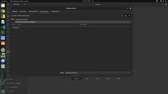

I click on Headset, thinking it will allow the mic to be used, but it simply doesn't. PulseAudio Volume Control still says "Headset Microphone (unplugged)". Clicking on Headphones doesn't help either.

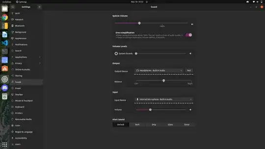

Checking for microphone options under settings doesn't even list the external microphone

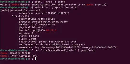

These are the details about my sound card and chip
Additional hardware info:

  1. Find out your machine's codecs with cat /proc/asound/card*/codec* | grep Codec
  2. In my case I saw Codec: Realtek ALC236 Codec: Intel Kabylake HDMI.
