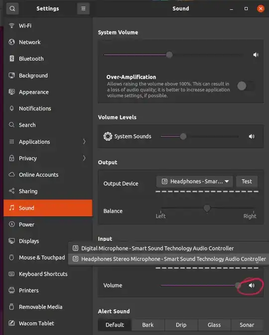

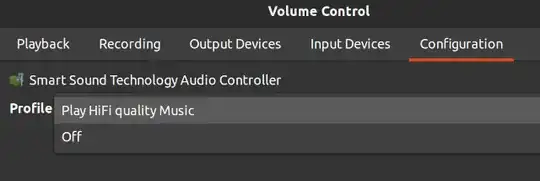

  1. there is only one profile in pavucontrol: pavucontrol only one profile whereas on my older machine with Xubuntu there are many more and I had been used to switch between "Analog Stereo Duplex" and "Analog Stereo output" to actually mute all mics in a convenient way.

-- these [[on|off]] change properly on un/muting in the internal's mic Sound settings: un/muting in sound settings unmuting2
