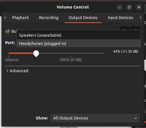

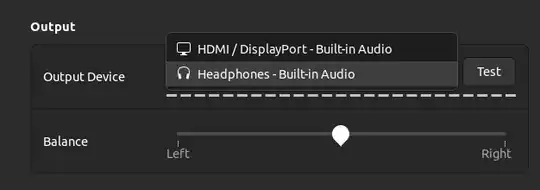

Edit: After plugging my 3.5mm Headphones into the headphone jack and rebooting, I get sound over the headphones. But if I unplug the headphones, I get no sound.
Image of Sound Output Devices in Settings
Image of Sound Output Devices in Volume Control

-1
Please try to clean up headphones socket from dirty It may think that that outside headphones connected
