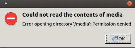

I tried snaps of the following applications such as gedit, arduino-mhall119, organize-my-files. All them show me errors if I navigate to /media folder:
trying to access /media
Could not read the contents of Media
Error opening the directory of '/media': permission denied

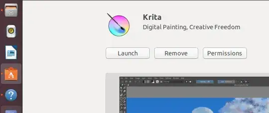

The Ubuntu Software program will now show a Permissions button on the page of each Snap program you have installed.
the Krita page of Ubuntu Software program showing the buttons under the title - Launch, Remove, and Permissions

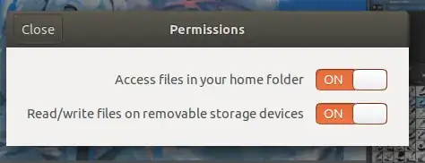

Click on Permissions, and a pop-up window gives you the option 'Read/write files on removable storage devices', with a button to the right that you click to turn this on.
You need to activate each program one by one this way, but there is nothing special to remember, other than that the button exists.

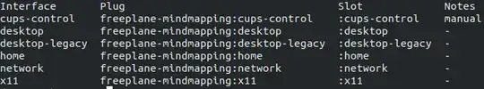

  4. Check to see which connections are enabled using snap connections freeplane-mindmapping, which should result is something like: enabled snap connections list
Note that the above output does not show the removable-media interface, but it does show a list of other interfaces started with cups-control and ending with x11. We will be adding removable-media after x11 in the .yaml configuration file for this snap app.

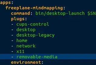

  5. Right click and Edit as Administrator the file snap.yaml.
  6. Scroll down to the section called plugs and enter in - removable-media after x11: enter image description here
  7. Save and close the gedit/editor

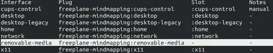

  6. Now snap connections freeplane-mindmapping should show removable-media. enter image description here
  7. Enable removable-media using snap connect freeplane-mindmapping:removable-media. You should now have access to removable media!
