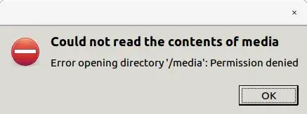

I then tried to configure a record session so that the output would be saved on a USB drive, but as soon as I try and access the /media folder for the Save As path, I get the following error: enter image description here

Currently we have "good" and "bad" snaps:
  • "Bad" snaps do not have access to removable-media.
  • "Good" snaps have access to removable-media. I created small list of them in other answer.
In your particular case (as you already wrote):
snap connect simplescreenrecorder:removable-media
will return
error: snap "simplescreenrecorder" has no plug named "removable-media"`.
So it can't access removable media by design.
But you have other option - remove this nice snap with
snap remove simplescreenrecorder
and install version from APT (as it is available in the universe repository):
sudo apt install simplescreenrecorder
