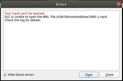

I have several video files of different types on this volume, and none of them are able to play with VLC, nor are they able to play with the pre-installed Videos application. This error message appears when attempting to open the video files in VLC:
I tried to find the log file, but despite turning on the log-to-file option (With debug verbosity) in preferences and supplying a non-read-only path for the file, no log file appeared.
If I move the video files out of /DATA/ and onto the ext4 volume, they play without issue. It may also be worth noting that video files on the Windows system partition, which is also NTFS but is NOT mounted in fstab and is accessed through "Other Locations," play without issue.

EDIT: It has been suggested that this issue is a duplicate of an issue relating to snaps accessing removable media. The fix for this other issue is changing a setting within Ubuntu Software; however, I found this setting to be set to the "correct" value by default. Curiously, even with the setting enabled, the snap version of VLC is still unable to access actual removable media (in addition to the non-removable drive mounted to /DATA/), so it appears that this option does not function properly for VLC at all. The apt-get version, however, can access everything.
VLC was installed as snaps, which wont auto-connect the media. More info on this issue on this link.
There exists two solutions:
Uninstall VLC snap
From chat conversation:
Fakename Bill: I uninstalled the snaps and re-installed the programs as packages, and both can now access /DATA. I'll be sure to check which type a program is before installing through Ubuntu Applications in the future.
Manually mount media
snap connect vlc:removable-media
