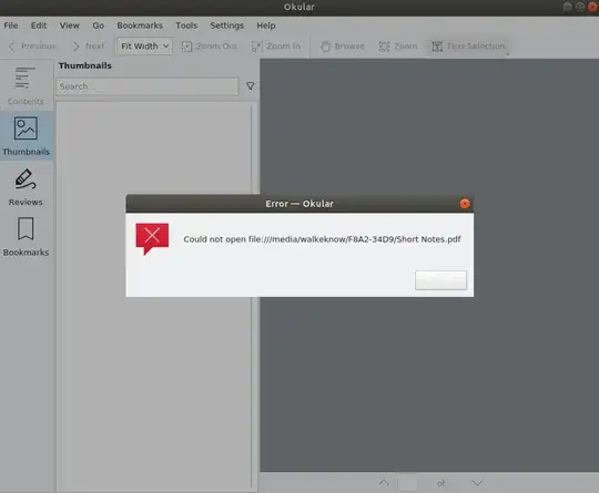

Whenever I try opening a PDF file in a mounted usb drive using Okular, it gives me this error: Could not open file:///media/walkeknow/F8A2-34D9/example.pdf
Okular error dialog
I have installed okular using sudo snap install okular because the apt-get method does not render the in-app icons for some reason on my system.
which okular command gives: /snap/bin/okular
The files open using Ubuntu's default Document Viewer evince. However I prefer using Okular. Is there any fix to this?

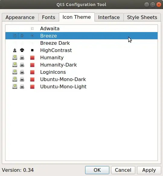

and select it from qt5ct with
QT_QPA_PLATFORMTHEME=qt5ct qt5ct
then switch to Icon Theme tab and select Breeze here and hit Save:
qt5ct

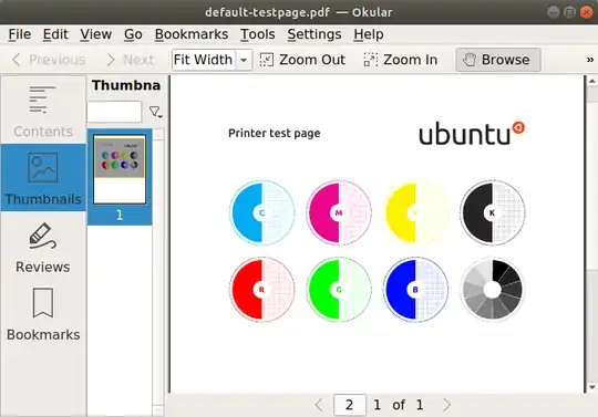

then reboot and use Okular with files from anywhere:
Okular on Ubuntu 18.04 LTS with GNOME
Note: I tested the method above on Ubuntu 18.04 LTS with GNOME Shell and MATE.
