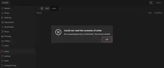

When I want to upload a new file to Microsoft teams that is on a different SSD I get the following error:
Could not read the contents of backup
Error opening dictionary '/mnt/backup': Permission denied
Error Image
