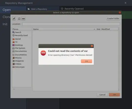

I'm trying to open an Apache project repository from GitKraken but I am getting error with permissions because I can't access the /var folder.
GitKraken permission error
My folder has this route: var/www/html/Catalogo. Inside the folder named 'Catalogo' I have my Git repository.
