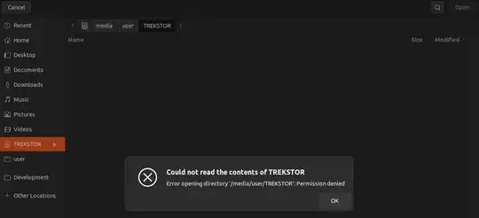

I have an external usb harddrive, which I usually use on a windows pc. It has NTFS. When I connect it with my ubuntu pc, it works immediately. I can access it in terminal and in nautilus. But when I try to open a file/folder from the app OpenComic, I get permission denied as shown in the screenshot. Help appreciated.

The question has been answered here.
The solution is that snap app needs to have the removable-media plug enabled in order to access USB storage and other drives.
