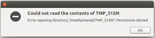

As you installed Firefox as Snap it is expected behaviour.
By default it has access only to the home folder. See this question and answer for details. And it will produce permission error on access to /media/$USER/drive/ folder:
Snap permission denied while saving page from Firefox
You should manually connect :removable-media plug to Firefox to remove this error
snap connect firefox:removable-media

If it does not work or you do not want to make such connection - remove Snap version with
snap remove firefox
and install deb-version instead (you will get 60.0.2):
sudo apt-get update
sudo apt-get install firefox
