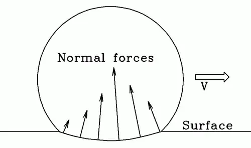

"Rolling friction" is a misnomer. Never be confused by it. Its not friction. Its ROLLING RESISTANCE-the correct name. It comes into play because objects are not perfect rigid in real life. It comes into play because of the deformation of shape of objects when in contact. When an object rolls on another WITHOUT slipping, there is a surface contact between them. enter image description here
It is the normal reaction that is responsible look at the diagram. A body rolling like this (in the diagram) is deformed and the normal forces on the front parts of the surface are always more (whether road is hard or soft) and results in a net backward force that will gradually stop the rolling body. The deformation depends on the nature of the two bodies, depending on their rigidity. Rolling resistance is usually less than static friction. Both are expressed in the same form where the coefficients are called coefficient of rolling resistance and coefficient of static friction. Experimentally, coefficient of rolling resistance is found to be smaller than coefficient of static friction for bodies with same mass. Coefficients are determined experimentally.

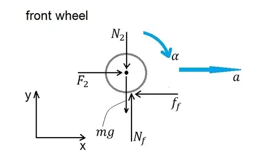

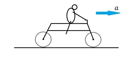

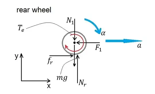

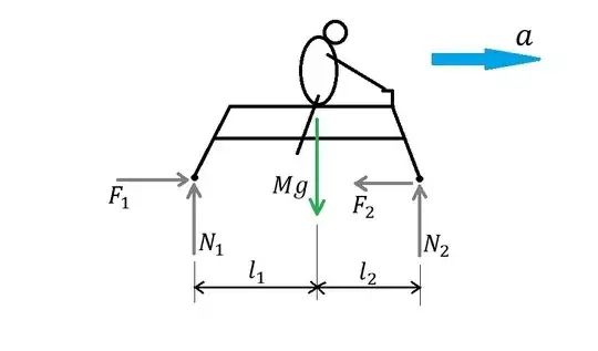

First off, I think it is better that we draw free body diagrams and write motion’s equations related to a motorcycle (for example). Consider that motorcycle is moving with acceleration $a$ on a rigid road. Assume that motorcycle’s wheel are rigid too. Rear wheel is driver. ($T_e$ is engine torque and $R$ is radius of the wheels) enter image description here Free body diagram for rear wheel is as figure below: enter image description here $$f_r-F_1=ma\;\tag 1$$ $$N_r=mg+N_1\;\tag 2$$ $$T_e-f_rR=I\alpha\;\tag 3$$ Free body diagram for front wheel is shown below: enter image description here $$F_2-f_f=ma\;\tag 4$$ $$N_f=mg+N_2\;\tag 5$$ $$f_fR=I\alpha\;\tag 6$$ Free body diagram for chassis and rider: enter image description here $$F_1-F_2=Ma\;\tag 7$$ $$Mg=N_1+N_2\;\tag 8$$ $$N_1l_1=N_2l_2\;\tag 9$$ The condition of non-slipping: $$a=R\alpha\;\tag {10}$$

Friction always prevents relative motion of surfaces in contact. Driver wheel (rear wheel in case above) tends to rotate due to torque exerted by engine ($T_e$). So, friction force ($f_r$) acts in a direction to oppose with wheel’s rotation. Driven wheel (front wheel in case above) tends to translate due to force transmitted to it by the chassis ($F_2$). So, friction force ($f_f$) acts in a direction to oppose with wheel’s translation. We can see all of these in above diagrams without assumption that road is soft.
How does the ridge provide rolling friction in the opposite direction of rolling?
As you can see in free body diagrams of the wheels, there is no need to have a ridge for existence of friction force. It is enough that two bodies are in contact and tend to move relative each other.
