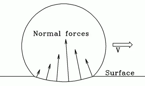

A rolling sphere slows down only when you stop applying the torque (basically when you instantaneously push a sphere forward rather than constantly applying the torque).
In the former case, once you have applied the instantaneous torque on a sphere, it will experience somewhat of a counter torque as its rolling due to the irregular surface of the sphere. This is due to the fact that in a deformed rolling sphere, the Normal forces from ground donot exactly pass through the centre of mass.
Counter Torque on a rolling sphere
Due to this counter torque, the sphere slows down. This also means that if you have a hypothetical sphere which has no deformation or irregularities, then it would not experience any counter torque (since all normal forces would pass exactly through centre of mass) and would roll forever. Also note that static and kinetic friction has no role in slowing a perfectly rolling sphere.
