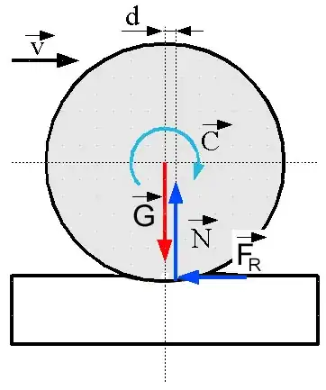

Note the following picture where the wheel rotates clockwise. The rolling friction force $\vec{F}_R$ points in the same direction as the rotation.
Normally, rolling friction inhibits the movement (speed $\vec{v}$) of the system. However, since the force is pointing in the "backward" direction, it looks like it is increasing the speed of the wheel. Therefore, it should accelerate the system. This seems unintuitive to me. Can someone please clarify this contradiction?
Thanks!
Rolling resistance
Update:
Based on the comments and answers, I have reconsidered the diagram and terminology. I mean rolling resistance and no static friction. The deceleration force caused by deformation (and other reasons). In the diagram above, this force is divided into its x- ($\vec{F}_r$) and y- ($\vec{N}$) components.
$\vec{v}$ is not independent of $\omega$ for pure rolling, since $v=R\cdot\omega$. To me, it looks like the resistance $\vec{F}_R$ that slows down the system accelerates $\omega$. And because of the kinematic connection between $\omega$ and $\vec{v}$, the latter must also increase. That's illogical, but I don't understand the reason. Maybe some comments or answers have already addressed that, but I don't understand :( This is really confusing.

I believe all you have is a misunderstanding of some terminology.
Rolling friction refers to the collection of effects that cause a wheel to resist rolling forward, not all of them being actual friction. These effects are dependent on the specific nature of the system, and are generally not modeled in detail in classical mechanics. For instance, if the wheel is on an axle, friction in the bearings can cause resistance. If the wheel or the contact surface are deformable, that deformation zaps energy from the rolling of the wheel, causing it to slow.
The frictional force in your diagram is actually static friction, which can theoretically provide any necessary force to prevent slipping at the contact point.
Rolling wheels do not pivot about their centers. They pivot about the contact point with the floor, or in the case of deformation the centerline of the contact. Move the center of rotation down by $R$ and reevaluate your torques; I think you will find they operate opposite of rotation.

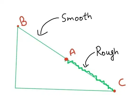

Consider a sphere on an inclined plane, with the upper half of the plane as smooth, and the lower half with sufficient friction for rolling.
Here, as usual the body will have an increase in its speed while sliding on the frictionless surface from point B to point A. But after point A, the speed will decrease, but angular velocity will increase. This seems to go exactly opposite to $v=R\cdot\omega$. Right? The reason for this is that pure rolling hasn't started yet - it is transitioning, so this formula is not yet applicable. Here, the resistance is doing negative work for translation, which is exactly equal to the positive work on rotation(you may use equations of mechanics to prove this).
In short, here the resistance is extracting some energy from translation and gives it to rotation, until they are in such a way that the condition for pure rolling is satisfied.
After point A(once pure rolling has started), whatever you are saying is valid, as obviously, the sphere will speed up while rolling down the plane.

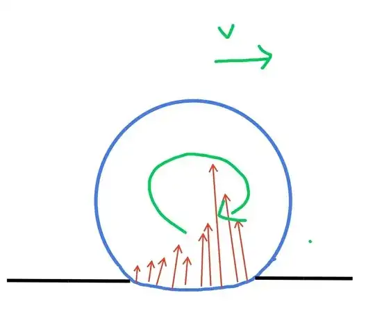

We have our good ol'blue sphere rolling towards right on the ground as shown here.
Here, a portion of the sphere is in contact with the ground, and the points on this portion will existence the force due to ground. In the figure, the red arrows indicate the forces, with their length proportional to the magnitude. The forces at the front will be greater than the forces towards the back. This is also clear according to this which says:
The resulting pressure distribution is asymmetrical and is shifted to the right. The line of action of the (aggregate) vertical force no longer passes through the centers of the cylinders. This means that a moment occurs that tends to retard the rolling motion.

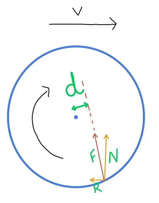

To analyze the forces, we can assume an equivalent force $F$, which will produce the same effect as all these forces combined, and will act as shown below:
Here, the torque can be given as $F.d$ which will act against the rotating motion(You can use simple geometry to understand why it will act against. If any issues with that, feel free to ask for clarification in comments). Further, this force can be divided into two components to analyse the resultant acceleration. The vertical component $N$ will not contribute towards linear acceleration as it will be balanced by the weight, whereas the horizontal component $R$ will act as shown, and contribute towards retardation, opposing the velocity.
In the end, it can be concluded that both angular velocity and linear velocity are decreasing due to the deformations.
We did not use the components to analyze the torque because both would produce torque in opposite directions, and there comparison might not be very obvious.
