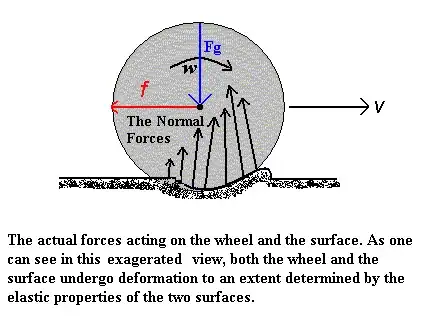

  • rolling friction is what you are refering to. Ideally there is no kinetic friction, and static friction only grabs the asphalt and doesn't reduce the speed (on horizontal surface and without wheel torque). All other forces that do work against the wheel rotation (except friction around the axle, as you also point out) are collectively called rolling friction.
Rolling friction happens of several different reasons. For example,
  • the rubber tires contract and expand and thus dissipate energy. The energy is taken from the rotation, and this factor counts as rolling friction. Also
  • the ground underneath might deform. The deformation costs energy and will as well cause a surface with normal forces that do not act radially (towards the wheel's center) anymore. Such forces will cause torques that might counteract the rotation. See the following picture from this source:
Without rolling friction (in an ideal world), the car will continue to roll and never stop. I believe this is the actual question that you have. Because you are right that in this sense, friction counteracting the motion has been eliminated as you describe.
