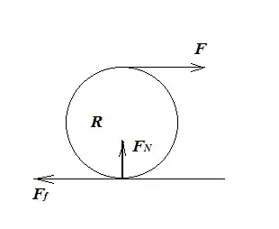

Consider the following digram for a monocycle.
Monocycle.
Through the drive-train the rider provides a torque $FR$ to the wheel. If sufficient friction can be provided by the normal force $F_N$ and the friction coefficient $\mu$, the friction force $F_f$ will provide torque to make the wheel turn and pure rolling starts (if not the rider will 'burn rubber').
Now assume the rider has been pedalling for a bit and has reached a speed $v$. With pure rolling (no slippage) this also means:
$$v=\omega R,$$
where $\omega$ is the angular speed of the wheel. At this point say the rider stops pedalling altogther: no more forces act in the horizontal direction and no more torque is applied to the wheel. Newton then tells us the status of horizontal motion must now stay unchanged: $v$ and $\omega$ no longer change. That also means no more friction is needed. Imperfect tyres of course always create rolling resistance but that's different from what we're discussing here.
But as long as the rider wants to accelerate (or decelerate) friction is needed even with pure rolling.
