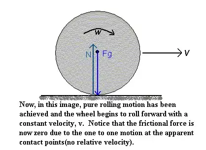

Your first quote is correct for an idealised model. There is no rolling friction then. Both wheel and surface are considered completely rigid.
Ideal model - no rolling friction

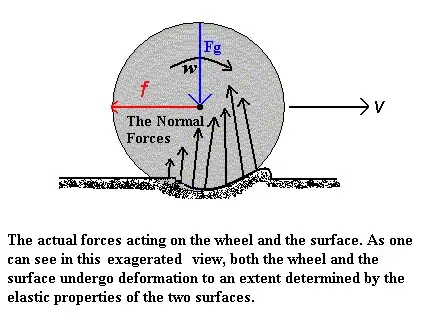

Non-ideal/more realistic model - rolling friction comes into the picture
These pictures are from this link that gives a very good graphic view on this. Going away from an ideal model introduces rolling friction since the wheel touches more than just one point, and not all points press back directly through the center - forces from such points cause counteracting torques, which is perceived as the rolling friction.

In the first case you mention, both the wheel and surface are assumed to be rigid, no deformation, so only one point of a perfect circle can be in contact with the surface at any time. The point in contact with the surface can be thought of as a, temporarily static, pivot. The rest of the body pivots around this and shifts the mass onto the next point of the circle, repeating, producing continuous motion.
In the second case (the more realistic case) the wheel and the rolling surface will be deformed due to the pressure from the weight of the wheel and the "equal and opposite" force of the surface acting on the wheel. (The amount of deformation in most rolling objects in small and difficult to observe.) In a simple case, this deformation tends to flatten a small area of the wheel in contact with the surface, increasing contact area of the wheel and surface, with respect to the ideal case (previous paragraph), increasing the friction between the two. This increased friction allows a greater torque to be applied before the wheel would "slip", and is why air/rubber tires are used on cars.
