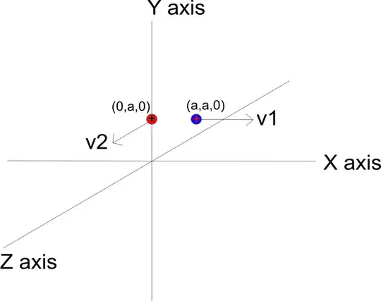

Consider a system of the two identical positive point charges situated in free space (isolated from the influence of any other external fields) as shown in the attached diagram. Particle $1$ is at $(a,a,0)$ and particle $2$ is at $(0,a,0)$. Their velocities, at the considered instant of time, are as shown in the diagram ($\mathbf{v}_1$ along the $+x$ axis, $\mathbf{v}_2$ along the $+z$ axis).
Now, by applying the Biot-Savart law, we find that the magnetic field due to particle $2$ at the position of particle $1$ is along $+y$ axis, which means that the force acting on particle $1$ is along $+z$ axis according to Fleming’s left-hand rule. A similar analysis shows that there is no magnetic force on particle $2$ as the magnetic field of particle $1$ should vanish at positions (relative to particle $1$) located along its velocity vector.
Now, if we observe the net torque on the system of two particles about the $y$ axis then it is non-zero and is directed along the $-y$ axis. Here, there are no external forces or torques acting on the isolated two-particle system, and yet the net torque, as well as the net force on the particles, are nonzero. Why? Also, Newton's third law of motion seems to be broken in this scenario. Why?

You are correct in your assertion that pairs of charged point particles can interact magnetically in ways that seemingly violate Newton's 3rd law, and therefore also seem to violate the conservation of both linear and angular momentum. This is a fundamental result and it is the decisive (thought) experiment which forces us to change our viewpoint on electrodynamics from something like
charged particles interact with each other
to a field-based one that says
charged particles interact with the electromagnetic field.
What this means, and the key point here, is that
  • the electromagnetic field should be considered as a dynamical entity of its own, on par with material particles, and it can hold energy, momentum, and angular momentum of its own.
The linear and angular momentum of the complete dynamical system, which includes the particles and the field, is indeed conserved. This means that in a situation like your diagram, where there is a net force and torque on the mechanical side of the system (i.e. the particles), there are corresponding and opposite net forces and torques on the electromagnetic field.
So, how much linear and angular momentum are there? This is a solid piece of classical electrodynamics: these momenta are 'stored' throughout space, with densities $$ \mathbf g =\epsilon_0 \mathbf E\times\mathbf B $$ and $$ \mathbf j =\epsilon_0\mathbf r\times\left( \mathbf E\times\mathbf B\right), $$ respectively. Once you account for these, it follows from Maxwell's equations and the Lorentz force that, for an isolated system, the total momenta are conserved. The details of the calculation are a bit messy, and so are the actual conservation laws; I gave a nice derivation of the linear momentum one in this answer.

The Lorentz force law adequately describes the acceleration of the point charges. Therefore we are dealing here with a paradox and it is misguided to hypothesise that the field carries off or brings in momentum.
The solution is in the interpretation of the Lorentz force law. Since the electric force does conserve momentum, as the forces on the charges are opposite and equal in size, I will concentrate on the magnetic part $f_B = q \vec v \times \vec B = q \vec v \times \vec \nabla \times \vec A$. Writing in components is easier, so $f_{Bi} = d(mv_i)/dt = q v_j \partial_j A_i - q v_j \partial_i A_j$. This can be written as $f_{i} = d \left(mv_i - qA_i \right)/dt = - q v_j \partial_i A_j$. It can easily be checked that $m \vec v - q \vec A$ is conserved.
The conclusion is that total momentum consists of a kinetic contribution, $m v_i$, and a potential contribution, $-q\vec A$, in the presence of electromagnetism.

Regard two charges moving at the same speed but in perpendicular diections:
The point is: yes, it is true, that according to laws of electrodynamics, the third law of Newton is violated here.
But this happens only temporary, at this very moment.
So, let's regard the situation at some moments after:
You see, that one charge have passed the crossroad, while another one have reached it.
And you can notice, that the charges have flipped they roles.
So, any momentum, which was owed by one charge, will be returned to it at this moment.
In other words, the reason of momentum conservation is not the field, but the symmetry. Field is just a credit holder here.
