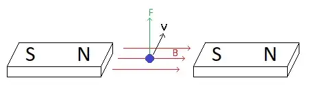

When an electron with charge $q$ travels with velocity $v$ perpendicular to a magnetic field generated between two permanent magnets with field strength $B$ and no electric field, it experiences a Lorentz force equal to $$F = qv \times B$$ The resulting change in momentum for the electron will be transferred through the magnetic field to the magnets. For example in a setup like this:
Lorentz force
the electron would experience a change in momentum upwards and the magnets would experience an equal and opposite change in momentum downwards, due to conservation of momentum.

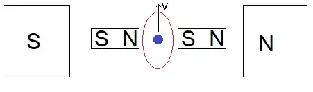

My question is, does this "reaction force" on the magnets also apply when you have a magnetic field inside a magnetic field, such that the superposition of the two fields results in no magnetic field at the electron's position. For example, lets say you have this following thought experiment with 4 magnets and a moving electron:
Electron in neutral region
Where the red oval represents zero (or essentially zero) magnetic field. The magnetic field lines pointing right from the small magnets exactly cancels out with the magnetic field lines pointing left from the big magnets. If you just had the big magnets the electron would experience a force down (into the screen), and if you just had the small magnets the electron would experience a force up (out of the screen), but these cancel out, so there is no net force on the electron.

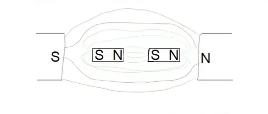

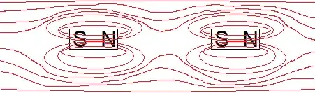

If you think there must still be a field between the two small magnets, either mentally increase the strength of the two larger magnets or mentally move the smaller magnets further apart. Here is a zoomed in visualization of the magnetic field lines to help visualize this. Sorry for the image quality:
This might seem counter intuitive, but it is possible because the strength of a magnetic field is proportional to the inverse cube of distance to the magnet. Imagine how a compass still points to earth's magnetic north, even if it is between 2 magnets spaced 100 meters apart.
So which of the following happens?
1) The big magnets experience a change in momentum up and the small magnets experience a change in momentum down.
2) None of the magnets experience a change in momentum. This would be the case if the experiment results in the magnets not moving.
The magnetic field between the inner magnets still exist, even with the stronger magnets outside. Magnetic fields, imaginated by field lines, are always closed loops (going even through the source) and opposite directed magnetic fields displace each other.
For permanent magnets it is clear that the source of the field are the aligned (and “frozen”) magnetic dipoles of the involved subatomic particles. With a very strong magnetic field you are able to destroy the alignment of the smaller magnet, but this leads again to a resulting magnetic field in the position of your electron.
