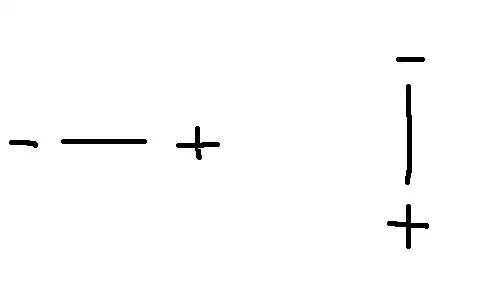

Consider two dipoles $({p_1}\hat{i}$ and ${-p_2}\hat{j})$ kept in the $x-y$ plane at $(0,0)$ and $(d,0)$ respectively. Calculate the torque about the COM.

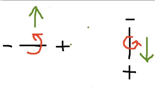

So yes, the left dipole gets a downward force on its negative charge and an upwards force on its positive charge, giving an anticlockwise torque. But the upward force is bigger as the + charge is nearer the second dipole, so there's also a net upwards force.
The right dipole gets a leftward force on the negative charge and an equal rightward force on the positive charge, giving another anticlockwise torque. But there is also a vertical component of force which is downward in both cases, again as the + on the LH dipole is closer than the -.
So each dipole gets an anticlockwise torque, but the joint system gets a clockwise torque. The maths in part 1 shows they balance. dipoles with forces

Both dipoles appear to experience an anticlockwise torque, around their own centers of mass. This is not the same as an anticlockwise torque around the origin, or around any other single point.
Each individual dipole rotates anticlockwise, but the two dipoles also move, in a clockwise direction around the origin. The overall angular momentum is conserved.
