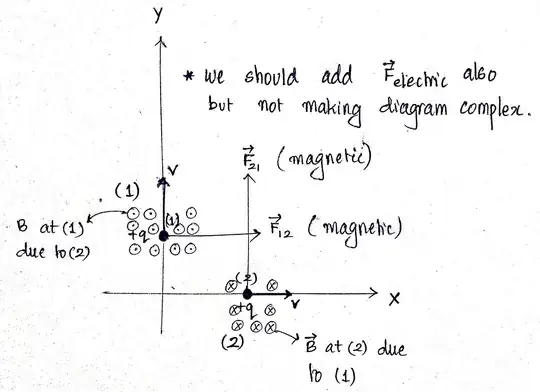

But later we study about lorentz forces, where sometimes (mentioned below) these conditions are not met, we still hold on to momentum conservation and assign momentum to fields. I don't understand how we can use law of conservation of momentum here when the assumption 1 itself breaks down. enter image description here

The conservation of mechanical momentum $\mathbf P_\mathrm{mech} = \sum_i m_i \mathbf v_i$ is guaranteed if the internal forces between the particles obey Newton's third law, $\mathbf F_{i\to j} = - \mathbf F_{j\to i}$.
As you've noted, for the Lorentz force between two moving charges, Newton's third law does not hold, and therefore neither does the conservation of mechanical momentum. This is handled by including the electromagnetic field itself as a dynamical entity, and in particular one which can hold momentum in its own right. This electromagnetic momentum $\mathbf P_\mathrm{EM}$ then combines with $\mathbf P_\mathrm{mech}$ to make the total momentum $$\mathbf P_\mathrm{total} = \mathbf P_\mathrm{mech} + \mathbf P_\mathrm{EM},$$ and it is this total momentum that's conserved.
