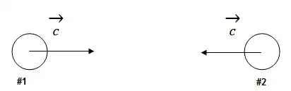

Let's say we have $2$ particles facing each other and each traveling (almost) at speed of light.
example
Let's say I'm sitting on #$1$ particle so in my point of view #$2$ particle's speed is (almost) $c+c=2c$, double light speed? Please say why I am incorrect :)
EDIT: About sitting me is just example, so in point of view of #1 particle, the second one moves at (almost) $c+c=2c$ speed?

One of the results of special relativity is that a particle moving at the speed of light does not experience time, and thus is unable to make any measurements. In particular, it cannot measure the velocity of another particle passing it. So, strictly speaking, your question is undefined. Particle #1 does not have a "point of view," so to speak. (More precisely: it does not have a rest frame because there is no Lorentz transformation that puts particle #1 at rest, so it makes no sense to talk about the speed it would measure in its rest frame.)
But suppose you had a different situation, where each particle was moving at $0.9999c$ instead, so that that issue I mentioned isn't a problem. Another result of special relativity is that the relative velocity between two particles is not just given by the difference between their two velocities. Instead, the formula (in one dimension) is
$$v_\text{rel} = \frac{v_1 - v_2}{1 - \frac{v_1v_2}{c^2}}$$
If you plug in $v_1 = 0.9999c$ and $v_2 = -0.9999c$, you get
$$v_\text{rel} = \frac{1.9998c}{1 + 0.9998} = 0.99999999c$$
which is still less than the speed of light.

In special relativity you cannot simply state that particle 2 is moving at c+c=2c in a reference frame where particle 1 is at rest.
Speeds add like this (easily found in wikipedia):
$$v_2^{'} = \frac{v_1+v_2}{1+\frac{v_1v_2}{c^2}}$$
i.e. the speed of particle 2 $v_2'$ in a reference frame where particle 1 is at rest is
$$v_2^{'} = \frac{c+c}{1+1} = c$$
you cannot move faster than at the speed of light in the vacuum.

Easy. you cannot sit on a particle moving at the speed of light. If you could then you would be massless, and unable to sum properly
In any case, there is no reference-frame moving with either photon, so no operational way to measure relative velocities between them. relative velocities have meaning only from a inertial frame. There are no inertial frames moving with the photon, otherwise this frame would measure that photon to be at rest

Perhaps your question is whether the speed of approach of the two particles is 2c, is this so? Yes, it is 2c and this does not violate the principles of relativity, because such speed is not the speed of a particle, but it is just a derived value. On the other hand, the speed of a photon is c regardless of the inertial frame, and is calculated by the relative speed formula, given in the previous answers.

I am assuming you have 2 particles facing each other, and that they are approaching each other ?
First, as mentioned elsewhere on this page, "..a particle moving at the speed of light does not experience time, and thus is unable to make any measurements."
Instead, let's change the particle #1 that you are sitting on to having a specific velocity that is less than c, and particle #2 will remain as v=c.
If your v=0, the combined velocity between you and particle #2 = c, and if you measure its velocity, you will measure a velocity of c.
If you accelerate to a new velocity, and v=100,000 km/s, the combined velocity between you and particle #2 will be 100,000 km/s + 300,000 km/s = 400,000 km/s, but you will still measure the velocity of particle #2 as c.
If you accelerate to a new velocity, and v=260,000 km/s, the combined velocity between you and particle #2 will be 260,000 km/s + 300,000 km/s = 560,000 km/s, but you will still measure the velocity of particle #2 as c.
In other words, you can change your velocity to a vast range of different velocities, yet when it comes to "measuring" the velocity of particle #2, the result is always c. This can be verified if you use the velocity addition equation. The important point is that neither particle has exceeded the speed of light. The combined velocity between 2 moving particles is a different matter altogether.

You are both correct and wrong.
If - sitting on one photon - you would measure the velocity of the approaching photon, the figure received would be exactly c.
However, if two photons separated by the distance of 1 light-year are sent toward each other, they will meet after exactly six months and exactly in the middle of this distance i.e. 1/2 lightyear. Go figure what the relative speed of these photons was :)
