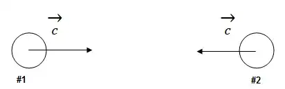

Let's say there are two objects going nearly the speed of light, in opposite directions.
Object 1 and 2 moving in opposite directions
Obviously from the vantage point of #1, #2 would be moving at about the speed of light, c. But assuming #1 thought it was stationary, what would be the perceived energy of #2 from the perspective of #1? In my mind it seems like this would make sense since the remaining energy wouldn't go into making it move faster
