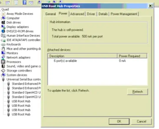

If running Windows...
go to >Device Manager > hardware > USB Hub (pick any) > property (rt mouse)> power
I hope this helps!! sorry about the fuzzy image.. this is a Mac .. you can see 500mA per port and the device connected = 0mA It has a built in current meter, what it doesn't do is make it easy for you to identify which physical hub and port it is referring to. I found moving a mouse to each port the easiest way to identify, but my learned colleagues may know a faster way.
BTW All the USB hubs are protected by automatic resettable polyfuses from short circuits. But I have seen at least one motherboard with blown electrolytic caps near the USB ports due to current surges, detected with the traditional popcorn bulging lid.

Yes I captured a high resolution image remotely on a Win7 tower and resized onto a low resolution Mac Air and enlarging turned out fuzzy, If you needed more resolution, I could have matched pixel resolution on this Mac by disabling autoscale, but that was hindsight and it wasnt essential. Beside it left some thinking why/how I was using a Mac to report about Windows Current monitoring features. The whole process took 1 minute. Besides with Windows 3rd party Apps I can easily see dpi and xy image sizes and edit. On OSX you need an expensive program to do it or use primitive Preview. – Tony Stewart EE75 May 12 '12 at 14:45
6If just resizing makes it that fuzzy you really need a decent image processing software! :-/ – Federico Russo May 12 '12 at 14:49
1Hey have you seen the USB spec? Their images are just as fuzzy as mine. See Figure 19-3 for example on Device Mgr. I agree thats why I said expensive program.. ( please not Gimp) .. Thats why I love Irfanview owned by Corel now. instant anything including adobe addons. – Tony Stewart EE75 May 12 '12 at 15:30
4Most cheap USB hubs I dealt with do not have any over-current protection (neither polyfuses nor series transistors). – jpc May 12 '12 at 23:37
