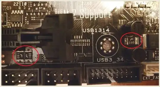

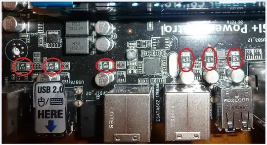

Sorry, but all answers are incorrect. Vast majority of PC mainboards do use polyfuses (aka resettable fuses) to protect USB ports from overcurrent and prevent damage from melting wires and connector's pins. Below are two examples, for ASUS Z170-A mainboard enter image description here And for ASUS P9X79LE enter image description here
USB specifications define that "high-powered hosts" must supply AT LEAST 500 mA for USB2, and 900 mA for USB3 ports (and more for Type-C). At least. General rule of design is consumer safety and to reduce OEM liability for setting fires, so the designers tend to limit the available current. High-side switches are expensive, and require even more expensive wire and extra pin on CPU or EC (or whatever). So simple polyfuses do their job quite economically.
Also, 95% (or (99?) of all usb hubs do use polyfuses as well.
As you rightfully found, maindoard use polyfuses at about double the minimum, some can supply up to the level of entire +5VSTBy limit (2.5 A and above).

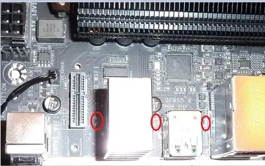

If someone still has a concern about newer mainboards, here is a snippet of Gigabyte X570 AORUS MASTER (released sometime in 2019), with polyfuses circled: enter image description here
Ale..chenski

  • Thanks! Can you state the date that these ASUS motherboards were introduced, so that it is easy to compare with other models' ages, without having to google them? And do you have any comment about the answer that claims that the X220 uses the TPS2069 power switch rather than a polyfuse? – user21820 Jul 17 '20 at 06:54
  • @user21820, yes, some high-end business-class (and enterprise-class) products do use more expensive high-side switches. Premium HP products use them more frequently. Laptops are more concerned with power limits of their battery, and tend to be more accurate in current limiting. – Ale..chenski Jul 17 '20 at 07:07
  • @user21820, regarding board introduction, are you banned from Google, or what? Initial BIOS release for Z170 is listed as 2015/08/10 – Ale..chenski Jul 17 '20 at 07:08

  • @DmitryGrigoryev, Gigabyte X570 AOURUS MASTER is not the cheapest mainboard on the market by all means, $300+. Your sentiment about "no protection at all" is completely out of line. Look more attentively into devices you have. – Ale..chenski Jul 17 '20 at 08:00

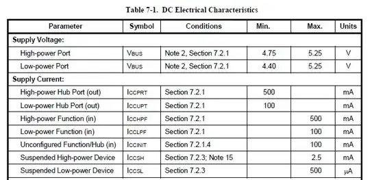

enter image description here Source: https://www.usb.org/sites/default/files/usb_20_20190524.zip (USB 2.0 ECN VBUS Max Limit.pdf)

  • Your most recently added table is not at all answering my question. Those tell you the maximum voltage and current the USB port is supposed to be able to supply, and has absolutely nothing to do with the over-current protection on USB ports in actual PCs. – user21820 Jul 16 '20 at 16:32
