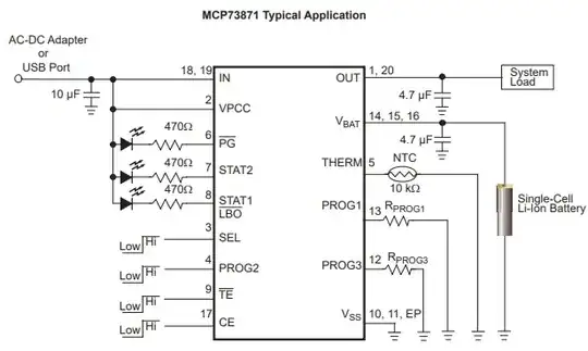

I'm using this Battery Charger IC.
My question is,
Datasheet mentions, if STAT1, STAT2, and PG# are connected to MCU then We need to connect a pull up do we need to pullup to MCU VCC voltage or MCP73871 Vin?
Regarding SEL Pin, Although, I have connected a pull-up on SEL Pin. If I connect USB Cable how will this be impacted…? Only the current that can be supplied will be different right? If I adjust the charging current to be less than 500mA. We should be able to power the device with either USB Cable or AC/DC Adapter right?
The datasheet states that STAT1, STAT2, and PG# are open-drain outputs. This means that they have a transistor between the pin and GND. When the signal is asserted, the transistor turns on and pulls the pin to GND. When the signal is not asserted, the transistor turns off and the pin is high impedance (Hi-Z), i.e. essentially left floating.
Each of those pins is designed to be able to directly drive an LED. You can see in the Typical Application Circuit on page 2 of the datasheet that each pin has an LED going from the IN voltage to the pin:
MCP73871 Typical Application circuit diagram from page 2 of the datasheet. Three LEDs with 470 ohm series resistors are connected from the input supply to the STAT1, STAT2, and PG# pins.
This arrangement acts exactly like a low-side MOSFET switch, except the MOSFET is inside the IC. When the STAT1, STAT2, or PG# signals are asserted, the MOSFET switches on and current flows from power, through the respective LED, to ground. When the signals are not asserted, the MOSFET switches off and no current can flow across it.
If you would rather interface these pins to a microcontroller (or some other logic input) instead of using them to drive LEDs, then you need a way to convert the open drain output (Hi-Z and GND) to two defined logic levels (VCC and GND). That's where the pullup resistor comes in - when the transistor is switched off, the resistor pulls the voltage up to some defined high state, rather than leaving the output floating (Hi-Z). The voltage that you should pull up to is, therefore, the voltage level for the input pin on the device (e.g. MCU) that you're trying to interface with. In this case, you'd pull up to VCC on your MCU.
