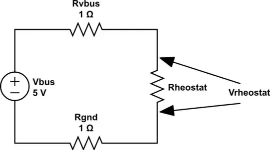

Ok, here's a simpler answer than my other long answer. So it sounds like this is how you are testing the chargers. Rbus and Rgnd represent the resistance in your "mouse" USB cable.
schematic
It sounds like you are measuring voltage after the high resistance mouse USB cable. So let's say you adjust Rheostat so that there is 250 mA flowing. Because of the total 2 Ohms resistance, you will get a voltage drop of 2 Ohms * 0.25 Amps = 0.5 Volts in the cable.
In other words, even though VBUS at the charger is 5V, the voltage across your rheostat (which is where the phone would be) is only 4.5 Volts because 0.5 Volts is lost in the wire: 0.25V across the VBUS wire and another 0.25V across the GND wire.
You need to measure voltage at the charger, so that's why I mentioned making your own USB cable using that DIY connector so you can measure VBUS right at the charger.
But I hope this also explains why a skinny USB cable charges your phone or power bank very slowly. It is because your phone is starved for voltage; it has to reduce its input current so it has enough voltage to work, typically 4.5V (which is actually the USB spec).

  • Yes, that's my test setup and you are right that I would have voltage drop and maybe this solves the mystery. The more current I draw, the more voltage drop I get on my mouse wire, so it's much less on the rheostat. It also explains why the old charger did measure right ... I used it's own cable and I guess they compensated for the resistance of the wire, because it did deliver 4.95V/670mA at the end of the plug. :) Thanks. – Komental Jan 23 '17 at 18:01

  • Thanks for your comment. I actually measured the usb test wire to be 1 ohm, so 2 wires = 2ohms. However if we add these 2 ohms to the overall test load the current ratings are not going to be much better. – Komental Jan 22 '17 at 16:29
  • That's my point. The 2 Ohms will cause so much voltage drop that there is no way you can get high current. You need to reduce resistance to much less than 1 Ohm. Do the math. – Vince Patron Jan 22 '17 at 17:47
  • I don't really get what you mean. I charge the bank with another thick Sony cable. The test cable is from a mouse and it does have resistance but the current is low on high resistance. For example the Samsung 2A charger drops the voltage to 4.5V at 21ohms and if we add 2 more ohms = 23ohms. 5V/23ohms = 217mA. – Komental Jan 22 '17 at 18:08
  • I'll post a clearer answer later today with a diagram – Vince Patron Jan 22 '17 at 18:47
    217 mA through 2 ohms would be almost a half-volt drop, so if that is where you terminated your test, then the cable is at least a contributing reason to why you terminated it. Your admission that you used a cable from a mouse shows that you are going about this without thinking through the issues - mice are low current peripherals that need hyper flexible cords, which is the exact opposite of what you want when trying to move large amounts of power at 5v potential. – Chris Stratton Jan 22 '17 at 20:10
