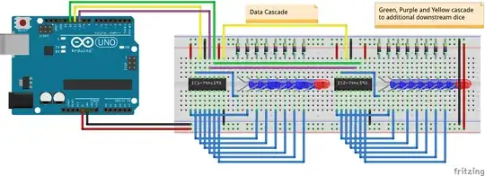

Following is a breadboard diagram (I tried using Eagle, but my EagleCAD skills are not that great)...
Dice Game - circuit diagram
The circuitry shown on the rightmost die is repeated 3 additional times to make up the total of 5 dice.

  • @StarCat I've added a circuit diagram created in Fritzing. The circuitry shown in the second (rightmost) die is repeated to add the additional dice as needed. – GMc Aug 03 '21 at 06:00

  • Have you measured voltages at various places during normal operation and when it starts to “fade”? My guess is either the breadboard connections add too much resistance or the USB hub cannot provide the required amount of power. – StarCat Aug 03 '21 at 06:10
