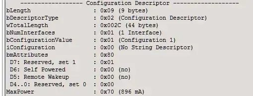

USB devices report their power consumption needs in "configuration descriptor", in MaxPower field of it, see an example for a USB 3.0 flashdrive:
This info must be revealed to host during initial stage of USB enumeration, when any USB devices don't take more than "one unit of load".
Classic USB devices (before the PowerDelivery era) do not ask for anything, they just "inform". In theory a USB host is supposed to look at the MaxPower data in early stage of device enumeration, and compare it with the available power budget (it should be known to a properly designed system) and either admit or refuse the new connection and let the device to consume up to its MaxPower.
However, if your USB host is on AC power, each port is mandated to supply "at least" 5 units of load, see details here. And here. And here.

  • "Classic USB devices (before the PowerDelivery era) do not ask for anything, they just inform". A device is requesting a current allocation with each config descriptor. You can have more than one with different values of bMaxPower and a host can cherry pick which one it will accept. You don't get to use any current above the default 1 unit until after the host notifies the device which configuration it has chosen. You are not guaranteed a host will select any configuration. – KevinThibedeau Feb 14 '24 at 20:59
  • @KevinThibedeau, I believe there is an important semantics here. A request in English means an act of asking for something by a requestor. A USB device does not make any requests, it only responds with information to requests from USB host. Saying that "a device is requesting" is therefore misleading and causes frequent confusion among unsuspecting public on how the classic USB operates. That's why I always prefer to stress this distinction. – Ale..chenski Feb 14 '24 at 21:41
