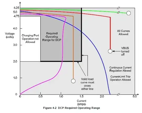

Dedicated charging port
ie no data - just charging MUST operate in dark grey area.
MAY operate in light grey area.

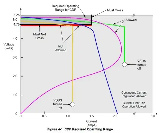

NB note that requirement for DCP is LESS stringent than CDP = Charging Diwnstream Port = data equipped downstream port,
which must maintain Voltage above 4.75V out to 1.5A.
Charging downstream port:
ie has data and charging capability.
May operate in light grey area.
MUST exit light grey area via right hand side only - ie while providing between 4.75V and 5.25V current drain must increase through 1.5A.
After that any area in light grey is valid.
