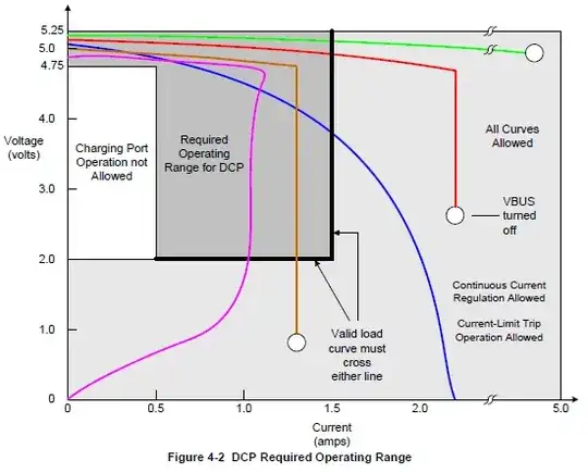

The charger has no brain in it; it just supplies 5 V until the current draw is too great, and then its voltage starts to droop:
DCP Required Operating Range
It's the "portable device" (PD) which has to be smart about limiting its own current draw from the DCP to stay within the dark region of the plot. So it can try to draw up to 1.5 A, but if the charger voltage drops below 2 V at 0.5 A, then you can't draw any more than 0.5 A from it.
For a dedicated charger or USB charger, the current limit is determined by loading the adapter. When the adapter’s output voltage starts to collapse, it is an indication that the current limit of the device is reached. - MAX8895 datasheet
