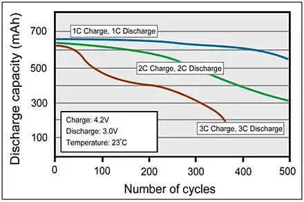

I am not asking how the battery gets damaged, because that answer is straightfoward.

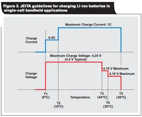

What I am asking is why lithium-ion chargers allow batteries to be damaged by excessive charge current in the first place. My understanding is that all lithium-ion chargers already support current limiting features in response to battery temperature (e.g. as part of "JEITA compliance"):
JEITA guidelines for charging Li-ion batteries in single-cell handheld applications
So why don't the chargers also enforce the maximum charge current, regardless of the wattage of the input power supply?

current vs lifetime

Important: Note that the reduction in maximum charging voltage with battery temperature is only of relevance when the battery is in the final stage CV (constant voltage) charging mode. For the majority of a charge cycle the battery is in CC (constant current) mode and the charging voltage is below Vmax - so the charger's CC limit has to be correct for the battery - altering the V in CV mode will not help at this point.

The maximum current allowed in CC mode for a given battery is set by the battery manufacturer. This is typically 1C but in some cases may be as little as C/2 and I have seen 2C quoted. I suspect that 2C may require special magic as if it was realistically achievable without compromising cycle or capacity lifetimes more manufacturers would offer it.

As well as thermal effects mentioned in the cited article maximum charge rates relate to the ability to properly "put the Lithium where it belongs" in the battery structure. Excessive charge rates can end up with pure metallic lithium 'where it ought not be' with capacity effects at best and vent with flame at worst. Among other things LiIon battery lifetimes are due to the structure being mechanically flexed as Li is moved around the cell. LiFePO4 cells avoid this issue by having a permanent olivine structure which the Li is 'moved' in and out of - with a resultant reduction in available energy storage capacity due to the inactive material.
