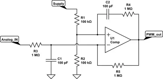

I've noticed that whilst I have a well-known solution using an NE555, that IC doesn't fulfill my needs perfectly. Others have told me that the NE555 is very rarely an appropriate solution to one of the problems it's being used for.
What are the systematic problems with the NE555?
More specifically, I'd like to have a better (lower part count / complexity, better stability, lower power consumption) solution for the following typical applications:
  • One-off timer (monostable multivibrator)
  • Ramp generator
  • Pulse-width modulator
  • Dear versed reader: please extend this list with typical applications!

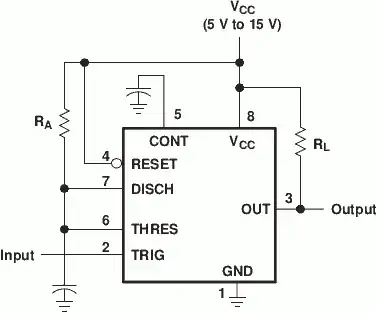

Application-specific replacements – Monostable operation (e.g., one-shot timers)
Typical NE555 schematic
Image from Datasheet
Problems
  • Low accuracy
    • Especially for long delays demanding large capacitances, very low accuracy
  • High stand-by power waste
  • High complexity for low-complexity problem

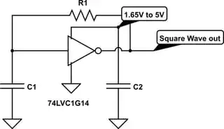

RC Time-constant-based buffered solution

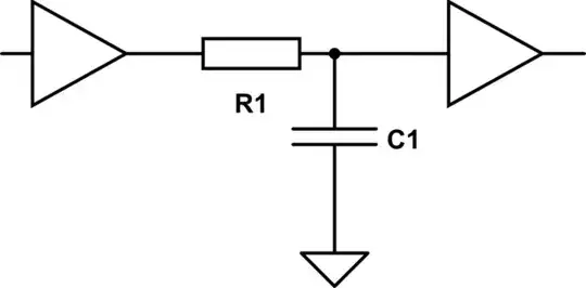

To at least remedy the supply and discrete semiconductor dependency, using a logic gate (typically, a "NOT" or "AND" or so) or buffer with well-defined input and output voltages is an appropriate approach. Schmitt triggering behaviour can be desirable, too, if your input is noisy or slow-rising.
To furthermore remove the influence on the properties of input, a buffer (or gate) applied to the input does well, especially since such are often sold in multi-component ICs (e.g., four buffers in one IC):
schematic
Note that, in the above, you could replace the buffers with inverters without changing the operation.
Due to the high input impedance of moderately modern logic ICs, you can pick high values for the resistor and thus low values for the capacitor, making the power usage of this very low.
The downside is still
  • behaviour depends on passive components, especially the capacitor's, specific value, and
  • it's typically hard to completely eradicate influence of the supply voltage.
But: due to the aforementioned high input impedance, it's often easier to build long-term timers than with a 555 this way.

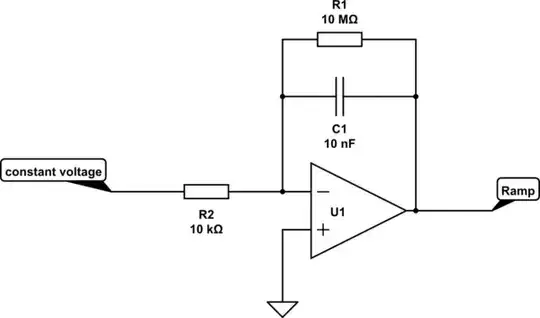

Op-amp integrator
Op-amp integrators are easy to build: just charge a capacitor in the feedback chain. You get the negative integral of you your input signal, with some capacitor and input resistor defined slope.
If necessary, make the input reliable by first using a buffer (or another op-amp in a (dampened) comparator configuration) on it.
Ramp generator
schematic
General op-amp integrator used as ramp-generator
This will simply give you a constant upwards slope, until the output hits the maximum of the op-amp (typically set by your op-amp's supply voltage). The slope is simply
$$ -\frac{V_\text{in}}{R_2\cdot C_1} \text,$$

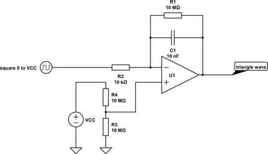

so for a triangle wave, you'd simply feed in a square wave, whose center point is the ground used for the non-inverting input:
Triangle-wave generator
schematic
simulate this circuit
Op-amp integrator used with a virtual ground at half VCC, fed with a 50% duty cycle square wave to generate a triangle wave.
Note that the downward slope happens while your input is high, and vice versa!

On the flipside, consider that if you are using only very basic functions of a 555, (such as basic low precision clock generation, triggering, ...) a simple comparator will do these things very well and you can use the same circuit/footprint with different comparators depending on if you need low power or very fast toggling.
Essentially take a comparator-based relaxation oscillator and play with the values around it. For example, you can even use it as a cheapo analog pulse width modulator creating a ~100 kHz PWM stream, whose duty cycle encodes the analog value. This can be used together with a counter to form an arbitrary precision ADC:
schematic
tobalt
  • 21,701
  • 22
  • 90
  • very nice! Got a link to an answer with a relaxation oscillator? I think people like to look at things and go "oooh, that's not actually harder than using a 555 with all its external components for the same job". – Marcus Müller Jan 01 '22 at 18:00
    @MarcusMüller I have added an example for a modulator, I think a basic clock generator is easy to figure out using google/wiki. – tobalt Jan 01 '22 at 18:09
  • that's really really cool of you :) – Marcus Müller Jan 01 '22 at 18:11
My favorite relaxation oscillator.
The 74LVC1G14 is a single CMOS Schmitt trigger inverter that operates from any voltage 1.65 to 5.5 V. Inputs and outputs are 5V tolerant if using lower supply voltages. Output currents to 25 mA source or sink. I have used it from 0.1Hz up to 1MHz should go higher.
schematic
RussellH
  • 15,016
  • 38
  • I've used various versions of the 7xxx 14 for many different purposes. About 20 years ago I used one as a switching regulator (! :-) ) in a production applicationfor use in Taiwan. I wanted something that used ICs available here and there and that I could be sure would work as desired. It needed very low quiescent current, ability to operate 4 x VERY depleted carbon-zinc C cells which were being loaded by a pulsating motor load - to provide the processor core with steady 5V and 3V3 loads when batteries were at bottom end of life but still being used (in some exercise equipment). It worked :-) – Russell McMahon Apr 04 '23 at 08:51
  • @RussellMcMahon:: This is the first 74xx series available that offered single logic elements in a package. Before, you had to buy fou or six and tie off the unused ones. – RussellH Apr 04 '23 at 11:32
