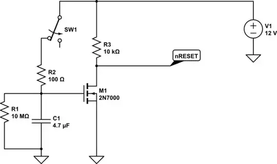

If you add the below 4 common parts you'll get a delay in the 50-70 second range roughly. You can use a ceramic 50V capacitor for C1 (eg. FG14X5R1H475KRT00)

  • Thanks! I do have two questions though: How would this be connected to my circuit? and Is the switch for initial turning on of the whole circuit? – Marius Mar 22 '21 at 16:50
  • The switch is your door switch and R3 is your 10K resistor that's already there. nRESET goes to the pin on the 555. – Spehro Pefhany Mar 22 '21 at 16:50
  • This is more inaccurate and variable than the 555 route the OP started with and far more so than the CD4060 solution, though. That's a technical assessment based on the performance, implementation cost, support cost, reliability and engineering education imparted of the circuit, it's not a silly "don't like the look of it" thing :-) – TonyM Mar 23 '21 at 15:18
  • @TonyM The 555 is still there- it is used to produce an annoying audible sound. The delay OP wants, using the circuit I suggest is to allow the user to exit or enter without triggering the alarm. Both are used here and both are suited to the application, even if they offend the sensibilities of some. – Spehro Pefhany Mar 23 '21 at 15:20
  • @TonyM Well, a CD4060 can't drive a speaker directly so he'd have to add some kind of amplifier. And figure out how to use a ripple counter to generate a time delay and gate the noise signal. The 555 can drive high current at 12V (one of its few positive points). Personally, I'd use an 8-pin MCU, a 78L05 and a transistor if I had to throw one these together for myself, but I'd like to give the OP as good a chance as possible at getting something working. If you want to provide a complete circuit using the CD4060 that appears likely to work, I'll certainly upvote it. – Spehro Pefhany Mar 23 '21 at 15:49
