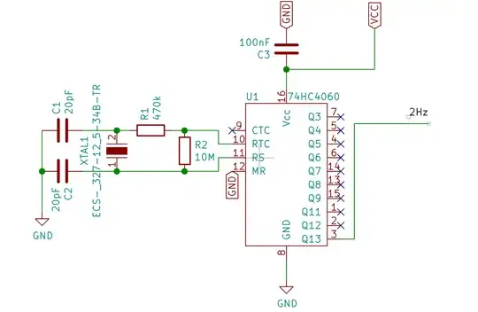

Here's the first part to make the reference:
From this Q: Calculating Rs Value for 32kHz Pierce-Gate Crystal Oscillator Circuit

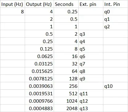

Now comes the second part. Take the 8Hz output (Q11) and feed it to a second 4060. Then that device has outputs that toggle as follows:
Now, you can decode count = 3600s, that is, one hour, as (2048 + 1024 + 512 + 16) off the second device when we see Q13, Q12, Q11 and Q6 = high.
Now, I explain why I chose 8Hz to the second stage: because I wanted to decode counts 2048, 1024, 512 and 16, and you'll see that Q10 isn't pinned out, so I scaled the counter bits so I didn't need to look at Q10.
This will give a 100's of PPM accuracy due to the watch crystal. I'll leave the rest of the design up to you, but I suggest using flip-flop with async set/reset to control MR and your device:
  • push button: set flop, Q=1=device on; Qn=0=MR, counter runs
  • decode count = 3600: reset flop, Q=0=device stops; Qn=0=MR, count stops

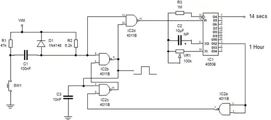

1 Hour Monostable
Components on the left produce a negative going pulse when SW1 is pressed which sets the RS latch and sets the counter running.
C3 ensures counter is in reset at power-up.
Set VR1 such that Q4 goes high 14 secs after SW1 is pressed which will ensure that Q12 goes high just about an hour after SW1 is pressed.
After an hour, when Q12 goes high, it will reset the RS latch which resets the counter ready for the next press of SW1.
High going, 1 hour output pulse available from output of IC2b. Low going, 1 hour output pulse available from output of IC2c.
C2 is a bipolar (non-polarised) electrolytic.
