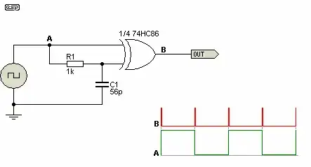

You need to find an op-amp that can handle below the negative rail input signals. There are few (not many and maybe hard to get). But when you do find one you will have a sinewave to square wave circuit and then you need to convert edges to pulses hence what I said about an RC circuit and an exclusive or gate.
So, use an exclusive or gate to turn a square wave (green) into a pulse output (red): -
Andy aka
