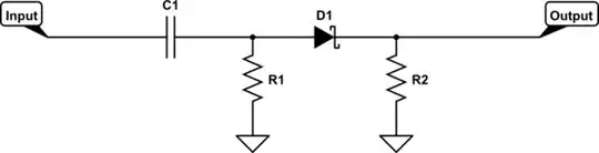

Here is one possibility
schematic
A "long" high input will result in a short positive spike at the output. R2 should be a somewhat "standard" pull-down resistor for the logic family which is fed by the output of this circuit. R1 serves to provide current back into C1 when the input goes low. The length of the pulse is of the order of $$C1 \cdot (R1 \parallel R2)$$ but not exactly, due the presence of D1 as well as the impedances of the components at the input and output of the circuit shown.

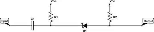

If you want the "inverted logic" (which is necessary for a standard 555 trigger) you may use this circuit:
schematic
simulate this circuit
With this circuit, the output is normally "high". However a "long" low input will result in a "short" low output.

  • Thanks, yes I mixed up the input, however it's no problem to just short it to ground instead of closing a circuit, so I should be able to negatively trigger it. Thanks for the negative signal shortening circuit. Pulse lengt shouldn't really matter with the 555 as long as its reasonable right? – Raphael Apr 13 '21 at 01:23
  • Yes, pulse length does not really matter as long as it is reasonable. – Math Keeps Me Busy Apr 13 '21 at 01:26
