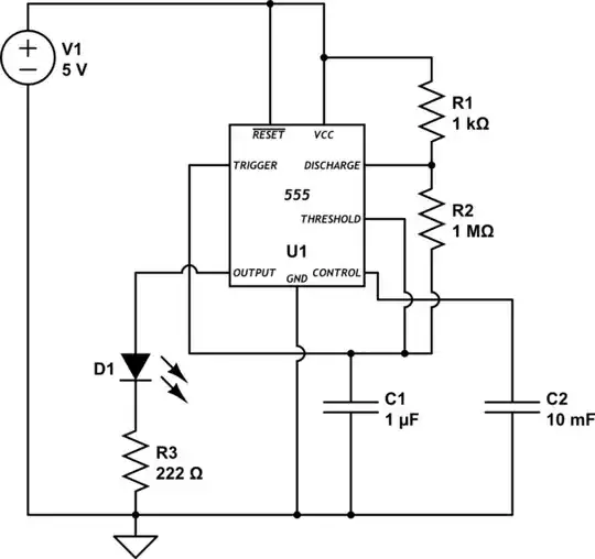

I'm working on Ben Eater's 8 bit computer, starting out with the clock. Specifically the astable 555 timer-based clock, the first module.
Astable 555 timer circuit
schematic
I've connected the breadboard with a 5V connection and have a 'canary' LED at the bottom of the breadboard with a wire connection to ground and a 220 ohm resistor to 5V that lights up, just to make sure there isn't an issue with the power.
The issue is that the LED doesn't oscillate. It just stays on.
I think that means potentially that there's an issue with the capacitor, but I've tried multiple capacitors of the same size, and tried one that was larger just to check.
Based on the calculator at allaboutcircuits.com, I should have a cycle time of 0.7s for the 1uF capacitor and 7s for the 10uF capacitor. But again, just getting a constant on.
I wondered if it was cycling so fast I couldn't see it, but according to the calculations that shouldn't be the case. I've also tried a couple of other resistors just to check and got the same thing.

    Is C2 actually 10mF (10,000uF) or is it 10nF (0.01uF)? Are you sure C1 is actually 1uF and not, say, 1nF? Maybe photos of the parts would help.. – Spehro Pefhany Jun 23 '21 at 00:01
  • I would guess that the LED appears to be always on however it is switching faster than the eye can follow. It is taking advantage of a property of the eye called persistence. – Gil Jun 23 '21 at 01:31
  • If C2 really is 10 mF it willl take a long time for it to charge to a stable voltage. – Oskar Skog Jun 23 '21 at 06:50
  • I've added some pictures of the parts you're asking about. C2 is .01uF, thought I got the conversion correct, but apparently not. – Mike Felts Jun 23 '21 at 11:33
  • Sorry, .01uF is the cap I have across + and - (not shown on the schematic as I couldn't figure out how to show it). C2 is .1uF (also pictured above). – Mike Felts Jun 23 '21 at 11:49
To start, add a 10 uF cap and 0.1 uF cap in parallel from pin 1 to pin 8 with the shortest possible leads. This is for power supply decoupling. The innards of a 555 are two analog comparators, and they expect a low impedance power source. Test the circuit.
Next, decrease R2 to 100K, increase R1 to 10K, and increase C1 to 10 uF. This is a test to see of the 555 is unhappy with the timing component impedances. A bipolar 555 does not work well with very high resistances or very high capacitances.

The cap value in your diagram is a bit off. 10mF (10 millifarad) = 10,000uF. I don't think that was your intention.

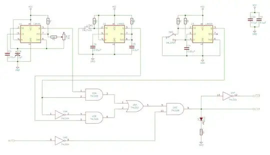

Anyway, I checked out Ben Eater's actual schematic for this thing.
Schematic from here: https://eater.net/8bit/schematics
Notice the 555 on the left (U1). The cap is 1uF, a variable pot with a max of 1M, and a 1k in series with the wiper. Turns out this matters.
I did a quick sim with 1uF and R2 set as follows, modeling the schematic:
  • 1.001M (max pot) = 0.71 Hz
  • 501k (mid pot) = 1.42 Hz
  • 1k (min pot) = 416.6 Hz - limited by the resistor on the wiper
As you can see this control will be highly non-linear. Maybe with a log taper pot it would be less heinous.
The rest of the clock stuff is for single-step. He's using U2 as a single-step one-shot and U3 as S-R flop to debounce the run/stop switch. All okay, I guess, though asynchronously switching the clock is bad as it can cause a glitch.
Finally, his diagram includes a 0.1uF bypass cap on CV (control voltage.) Recommended.

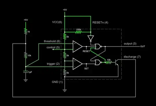

As a way of explaining how the 555 works, here's a simulation showing its internals (simulate it here):
What's supposed to happen is the capacitor charges up, when its voltage reaches 2/3 VCC the upper comparator fires and resets the latch, starting the process of discharging the cap. When the cap voltage reaches 1/3 VCC, the latch is set by the lower comparator, stopping the discharge and allowing the cap voltage to rise again.
So as it oscillates, the cap voltage should be ramping between 1/3 and 2/3 VCC.

  • The schematic he shows is for the final form. I think the only thing I've switched out is the variable pot (I'm going based on an intermediate part of his 1st video) as I wanted to make sure that wasn't the issue. I've tried it with the variable pot in place as well (with the 1k resistor inline) and it didn't make a difference, so wanted to remove variables to troubleshoot as it -should- be oscillating without the variable pot in place of R2. – Mike Felts Jun 23 '21 at 11:37
  • I have a .1uF cap on CV (C2, the one I marked as 10 mF by mistake) and also have a .01uF cap across positive and negative (not shown in the schematic because I couldn't figure out how to draw it). – Mike Felts Jun 23 '21 at 11:39
